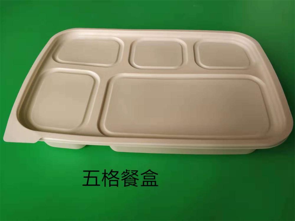

      可降解一次性環(huán)保餐具生產(chǎn)工藝主要流程是:根據(jù)訂單要求由甘蔗漿、竹漿等按照比例混合所成,同客戶對產(chǎn)品的要求不同,甘蔗漿、竹漿的混合比例也有所不同。將甘蔗漿、竹漿漿按照不同的比例,放入水力碎漿機(jī)浸泡,浸泡5分鐘左右,起動(dòng)水力碎漿機(jī)進(jìn)行碎解,碎接好的漿液放入配漿池中稀釋,在稀釋過程中添加防油劑和防水劑,配漿池?cái)嚢杵鲗{液攪拌均勻,接著將稀釋后的漿液用漿泵抽入供漿池中,持續(xù)攪拌,這樣制漿過程完成。
      The main process of producing degradable disposable environmentally friendly tableware is to mix sugarcane pulp, bamboo pulp, etc. in proportion according to the order requirements. The mixing ratio of sugarcane pulp and bamboo pulp varies depending on the customer's requirements for the product. Firstly, soak sugarcane pulp and bamboo pulp in different proportions in a hydraulic pulper for about 5 minutes. Then, start the hydraulic pulper for crushing and dissolving. Dilute the crushed slurry in the mixing tank, add oil and waterproof agents during the dilution process, and the mixing tank mixer will stir the slurry evenly. Then, use a slurry pump to pump the diluted slurry into the slurry supply tank and continue stirring. This completes the pulping process.
      將供漿池內(nèi)的漿液用漿泵通過供漿管道輸送到到一次性環(huán)保紙模自動(dòng)生產(chǎn)線的成型機(jī)臺(tái),在成型機(jī)臺(tái)上經(jīng)過真空吸濾去掉漿液中的水分,使?jié){液中的纖維吸附在成型用的絲網(wǎng)上,形成濕胚,通過機(jī)械手將濕胚和絲網(wǎng)一起轉(zhuǎn)移到熱壓定型機(jī),在230左右溫度和15噸左右壓力下,用熱壓模具將濕胚中水分?jǐn)D掉,并將濕胚烘干,形成半成品。
      The slurry in the slurry supply tank is pumped through the slurry supply pipeline to the forming machine of the disposable environmentally friendly paper mold automatic production line. The moisture in the slurry is removed through vacuum filtration on the forming machine, allowing the fibers in the slurry to adsorb onto the forming wire mesh, forming a wet embryo. The wet embryo and wire mesh are transferred together to the hot pressing shaping machine by a mechanical arm. At a temperature of around 230 and a pressure of about 15 tons, the moisture in the wet embryo is squeezed out using a hot pressing mold, And dry the wet embryo to form a semi-finished product.
      將定型后的半成品轉(zhuǎn)移到切邊崗位,通過切邊機(jī)用切刀將多余邊料去除。
      Transfer the finalized semi-finished products to the edge cutting position and remove excess edge materials using a cutting knife through the edge cutting machine.
      切邊后產(chǎn)品轉(zhuǎn)移到檢驗(yàn)工序,檢驗(yàn)工按照客戶的標(biāo)準(zhǔn)進(jìn)行檢驗(yàn),將不符合客戶要求的產(chǎn)品挑揀出來,符合要求的產(chǎn)品轉(zhuǎn)移到包裝工序,利用紫外線機(jī)進(jìn)行,經(jīng)過的產(chǎn)品在封閉的無菌包裝間包裝后入庫存放。
      After trimming, the product is transferred to the inspection process. The inspector inspects according to the customer's standards, picking out products that do not meet the customer's requirements. Products that meet the requirements are transferred to the disinfection and packaging process, and disinfected using a UV disinfection machine. The disinfected products are packaged in a closed sterile packaging room and stored in the warehouse.
