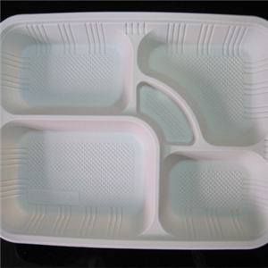

      玉米淀粉基降解環(huán)保餐盒,是采用玉米淀粉及植物纖維為基料,輔之以生物聚酯、多元醇等物質(zhì)加工而成,其淀粉含量高可達(dá)80,在土壤和自然環(huán)境下可以自然降解,對(duì)環(huán)境沒有污染、無破害。那么您知道玉米淀粉顆粒可降解餐盒成型遇到問題有哪些嗎?
      The corn starch based degradable environment-friendly lunch box is made of corn starch and plant fiber as the base materials, supplemented by biological polyester, polyols and other materials. Its starch content can reach 80, which can be naturally degraded in soil and natural environment, without pollution and damage to the environment. Do you know the problems encountered in the molding of corn starch granules degradable lunch boxes?
