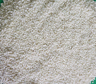

      一、顆粒狀態(tài):
      1、 Particle state:
      (1)預(yù)熱和干燥:
      (1) Preheating and drying:
      原料預(yù)熱干燥1.5-2min,物料溫度升到80C°-100c°。原因是原材料中的水分含量往往過高。如果直接放入桶內(nèi),產(chǎn)品表面會變暗、顏色不均勻和表面起泡。但預(yù)熱時間應(yīng)適當(dāng),溫度不宜過高。溫度過高會導(dǎo)致產(chǎn)品表面出現(xiàn)焦斑;預(yù)熱溫度過高或預(yù)熱時間過長會導(dǎo)致產(chǎn)品表面顏色不均勻。
      The raw materials are preheated and dried for 1.5-2 min, and the material temperature rises to 80C ° - 100C °. The reason is that the moisture content in raw materials is often too high. If it is directly put into the barrel, the product surface will become dark, the color will be uneven and the surface will bubble. However, the preheating time should be appropriate and the temperature should not be too high. Too high temperature will cause focal spot on the product surface; Too high preheating temperature or too long preheating time will lead to uneven product surface color.
      (2)加料計量:
      (2) Feeding metering:
      投料量應(yīng)準(zhǔn)確。如果原料太多,產(chǎn)品會有太多的飛邊,難以清洗;如果原料太少,成型壓力不足,產(chǎn)品無法完全固化。
      The feeding amount shall be accurate. If there are too many raw materials, the product will have too many flash, which is difficult to clean; If the raw materials are too few and the molding pressure is insufficient, the product cannot be completely solidified.
