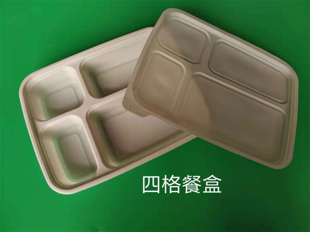

      經(jīng)一次熱壓成型得到的餐具產(chǎn)品原料低廉,餐具整體可自行降解為有機肥料,且降解速度快,無害,環(huán)保。
      The raw materials of tableware products obtained by one-step hot pressing are low, and the tableware can be degraded into organic fertilizer by itself with fast degradation speed, non-toxic and harmless, safety and environmental protection.
      一次熱壓成型比常壓成型得到的產(chǎn)品強度更高,工藝簡單,可操作性高,易于推廣;并且可方便得到不同尺寸、形狀和厚度的餐具。
      Compared with normal pressure molding, one-time hot pressing molding has higher strength, simple process, high operability, easy to promote, and can easily get different sizes, shapes and thicknesses of tableware.
      根據(jù)模具的不同,采用該研究所述方法可制備各種尺寸和形狀的餐具或器皿,比如盤子、碗、筷、勺子、餐盒、育苗盒等。
      According to different molds, tableware or utensils of various sizes and shapes can be prepared by the method described in this study, such as plates, bowls, chopsticks, spoons, lunch boxes, seedling boxes, etc.
